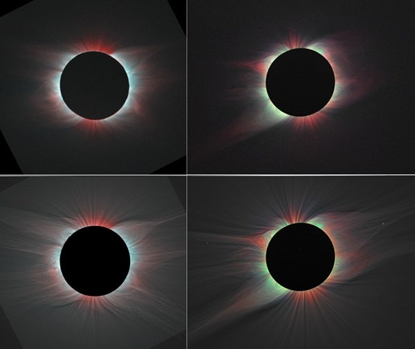

Solar corona electron temperature and ion charge state
These images of the solar corona are color overlays of the emission from highly ionized iron lines for the 2006 eclipse (left column) and 2008 eclipse (right column), with white-light images added in the bottom row. Red indicates iron line Fe XI 789.2 nm, blue represents iron line Fe XIII 1074.7 nm, and green shows iron line Fe XIV 530.3 nm. These are the first such maps of the 2-D distribution of coronal electron temperature and ion charge state.
Habbal, et al.

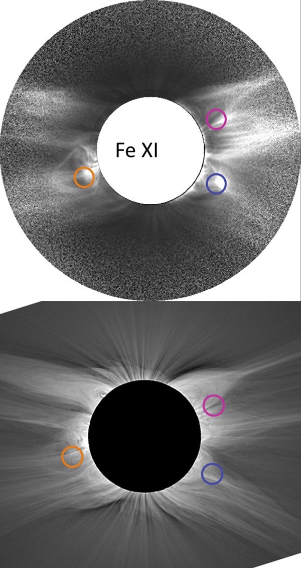

“The first image of the corona in Fe XI 789.2 nm was taken during the total solar eclipse of March 29, 2006,” said Daw.
The images revealed some surprises. Most notably, they showed that the emission extends out at least 3 solar radii — that’s 1.5 times the Sun’s width at its equator — above the surface of the Sun, and that there are localized regions of enhanced density for these iron ions.
Solar corona Fe XI 789.2 nm comparison
Compare the first image of the corona in Fe XI 789.2 nm, taken during the 2006 eclipse, with a white-light image taken by Miloslav Drückmuller from Brno University of Technology in the Czech Republic. The colored circles indicate localized enhancements in Fe XI that have no correspondence in white light, while the bubble structure surrounding the yellow circled region is barely distinguishable in white light.
Habbal, et al.
Combined with observations of other iron charge states, the observations yield the two-dimensional distribution of electron temperature and charge-state measurements for the first time, and establish the first direct link between the distribution of charge states in the corona and in interplanetary space.
“These are the first such maps of the 2-D distribution of coronal electron temperature and ion charge state,” said Daw.
