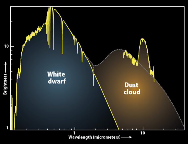

Spitzer doesn’t send home dazzling wall-art images of disks; this is not its specialty. It is best at dissecting light, wavelength by wavelength, to form a spectrum. Most of the light it analyzes has wavelengths within a few times that of the width of a human hair. One by one, Spitzer pointed to all the dusty stars of the different types in the sky, collecting spectra of the objects that we and other astronomers thought we knew well.
Often, when it looked at an ordinary debris disk around a normal star, Spitzer would find a characteristic glove-shaped bump in the mid-infrared. Everyone in the field soon came to know this meant the presence of small grains of silicates — like grains of fine beach sand.
When we first saw the spectrum of G29–38, we felt strangely queasy. On the one hand, it confirmed what we already thought we knew — that dust explained the extra infrared light coming from this dead star. On the other hand, when we spotted that ordinary glove-shaped bump in the spectrum (see “Dust’s telltale signature” at left), the hair stood up on our necks like we’d seen a ghost.
We were used to seeing this pattern in young disks. There it tells a happy story, one about baby planetesimals colliding together to form planets. But G29–38 is not a happy place. A line in the Bible says we are born from dust and to dust we shall return — well, the dust around white dwarfs is the dust we shall return to. At least one astronomer referred to the G29–38 spectrum as the “signature of the angel of death.”
