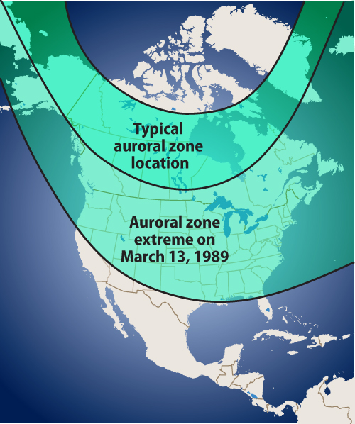

Two days later, the swarm of solar particles finally struck Earth’s magnetic field at 1,000 miles per second (1,600 km/s). The solar material, channeled along Earth’s field lines, swarmed into our atmosphere near the poles. Instantly, it created enormous electrical currents in the thin air, giving birth to the most spectacular displays of the northern lights in many years.
You didn’t need to be in Alaska. The aurora flickered over skies in the southern United States. While compasses went crazy, electrical currents surged beneath the displays. Garage doors all over the continent went up and down all night long. The ground itself sizzled; areas with high concentrations of igneous rock experienced geomagnetically induced currents in power lines.
At 2:44 a.m. on March 13, the Sun induced surges wreaked havoc on Quebec’s power grid. The 100-ton capacitor Number 12 at the Chibougamau substation tripped and went offline. Two seconds later, a second capacitor blew, and then 100 miles away at the Albanel and Nemiskaustations, four more capacitors went down. When yet another died and five transmission lines from James Bay tripped, the 9,460-megawatt output from Hydro-Quebec’s LA Grande Hydroelectric Complex stopped.
