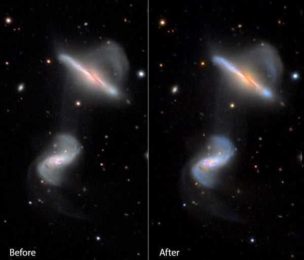

To do this, create an inflection point by clicking on the center of the diagonal line (the input and output values will be equal), and then create your curve (see Image #3). If your curve has the same shape as mine, you will see a transformation (see upper right image). What was once dull blue will become vibrant azure, and muddy reds will become more luminous yellows.
Adjusting the B channel is especially effective for spiral galaxies and certain types of reflection nebulae. You can adjust the A channel in a similar way to enhance reds and magentas of an image. This is good to know for enhancing emission nebulae.
This frame of NGC 6286 shows the difference between before (left) and after applying a contrast adjustment to the B channel. The author pushed the effect a bit more than normal in order to make sure it showed well in print. You’ll find a high-resolution version of NGC 6286 at http://skycenter.arizona.edu/gallery/galaxies/ngc6286.
