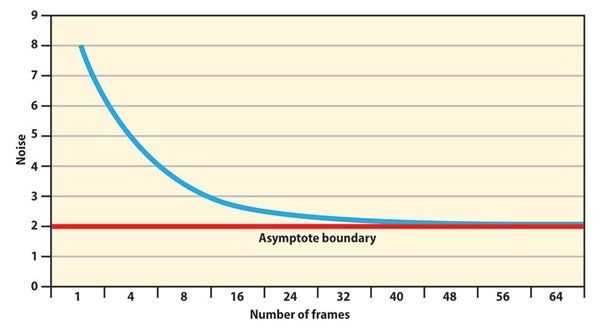

Looking at the graph at left, we notice something interesting. The level of noise does drop dramatically with the averaging of multiple frames at first, but then something strange happens: The curve begins to level out. Specifically, the improvement is substantial up to 16 frames, but after 25 frames, the improvement basically ends.
Combining-frames
Combining a number of dark frames decreases noise initially, but after about 16 frames, the improvement fades as the noise level slowly approaches (but never reaches) the asymptotic boundary. Astronomy: Roen Kelly, after Tony Hallas
We call this boundary an “asymptote” — a certain number that a changing value approaches but never arrives at. Put another way, there comes a time beyond which further data collection achieves nothing in terms of noise reduction.
Related to this is the signal-to-noise formula: The improvement of signal to noise equals the square root of the number of frames combined. Four frames will thus double the signal over the noise, 16 frames will have a fourfold increase, and, theoretically, 25 frames will see a fivefold increase. Remember that at 25 frames, we’re getting close to the asymptotic boundary, beyond which noise doesn’t improve. Plus, the difference between four times and five times improvement is slim to begin with. Adding nine more frames accomplishes basically nothing.

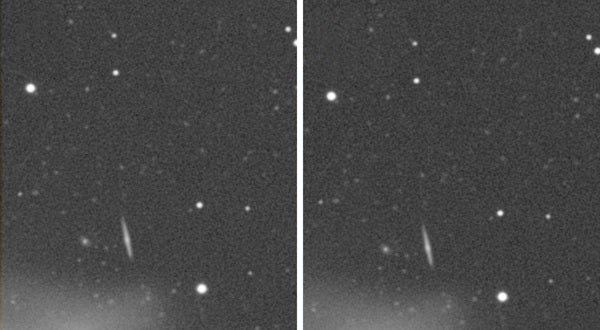

In my experiments, I couldn’t see any improvement after combining nine dark frames. Indeed, comparing the results of a three-frame dark and a 40-frame dark revealed no visible difference when I combined the light frames as a mean (average). See the photo comparison at right for a visual reference.
Noise-reduction
The rate of return for noise reduction diminishes quickly in the author’s experiments. Note that the apparent noise level is identical between a three-frame dark (at left) and a 40-frame dark. Tony Hallas
