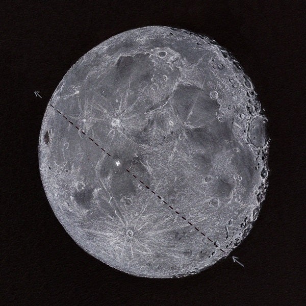

The author sketched the ISS transit of the Moon on September 11, 2014, from Leander, Texas. She used a 4-inch f/9.8 refractor on an equatorial mount with a 16mm eyepiece and a 13 percent transmission Moon filter for a magnification of 62.5x. She completed the sketch on black Strathmore Artagain paper using white pastels and black and white charcoal. She drew the ISS and transit line with a white gel pen and a black artist pen, respectively, and then scanned the sketch. North is to the top, and west is to the left.

ISS transits of the Moon and Sun are a real treat and require a different approach. The Web-based celestial calendar at www.CalSky.com can predict the exact time and place to observe the central line of a transit and will email you with alerts for upcoming events. A tracking mount is useful so that the Sun or Moon remains centered in the eyepiece.
For my observation, I started the lunar sketch well in advance and used the app GoSatWatch on my smartphone to set off two alarms — five minutes prior to the pass and at the expected time of transit. When the first alarm sounded, I stopped the sketch and continuously observed the Moon’s limb edge where I expected the ISS to appear.

The space station crosses the disk in under a second. In that brief moment, I made a mental image of the points of its entry and exit, as well as its brightness, aspect, and size compared to nearby craters. Sunlight illuminated the ISS the morning of my observation. It would have appeared as a silhouette had it been in Earth’s shadow. Immediately following the event, I added the ISS and its path before completing the sketch.
