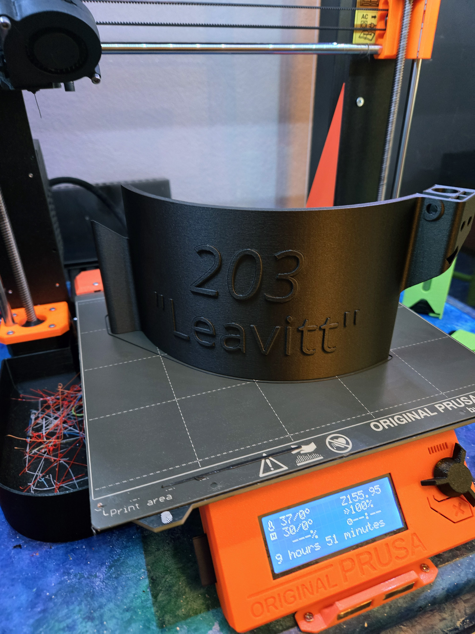

One of the components of the Leavitt comes to life on the author’s 3D printer. Credit: Molly Wakeling
For printing, I used a carbon fiber High-Temperature Polylactic Acid (HTPLA) composite from Protopasta instead of regular PLA. While more expensive at $80 per kilogram, it is more rigid and less reflective than regular PLA. Most importantly, it is heat treatable. Regular PLA softens around 120 degrees Fahrenheit (48.9 degrees Celsius), which isn’t ideal for gear left in a hot car at summer star parties. Heat-treated PLA will stay rigid until 310 F (154.4 C).
