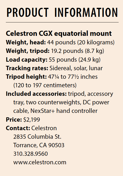

The specs
At a weight of 63.2 pounds (28.7 kilograms) – 44 pounds (20 kg) for the head alone – and sporting a 55-pound (25 kg) capacity, the CGX mount is the new Celestron workhorse for scopes with apertures of 6 to 11 inches.
The CGX reflects an overall redesign to accommodate new control systems for both observers and imagers. It features internal cabling and two AUX ports, which support both SkyPortal WiFi and StarSense AutoAlign technology. For those observing remotely, Celestron has included sensors that return the mount to its index position in case of a power failure. Also, the sensors will shut off slewing or tracking before the system reaches its hard stop to prevent damage.
Imagers will be pleased with the new software to control operation and imaging. Particularly attractive is the ability to compensate for individual variations in the mechanics of the mount through multipoint mount modeling. Additionally, you’ll find an autoguider port and a USB 2.0 port (for software updates). Celestron also touts the fact that the mount supports Programmable Periodic Error Correction. The drive system is now belt driven with spring-loaded worm gears to ensure a solid connection.
And, of course, the Celestron NexStar+ control drives the entire system. If you’ve used the NexStar system within the past few years, you’ll feel right at home. The 40,000-object database contains the Messier, NGC, Caldwell, and other astronomical object catalogs.

As you unpack, you’ll find a tripod, accessory tray, hand controller, GEM head, two 11-pound (5 kg) counterweights, and a DC power adapter. The combined 22 pounds (10 kg) of counterweights should be sufficient to balance most equipment while keeping the entire setup under the 55-pound (25 kg) rating. Celestron also offers an AC power adapter and 17-pound (8 kg) counterweights as options. In the box, you’ll find a code to download a special Celestron edition of the Starry Night 7 software for Windows or Mac.
