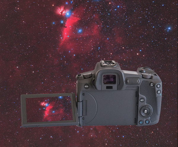

One of the most striking features of the Canon Ra is its vari-angle LCD screen, which makes it a breeze to view your target no matter where the camera points. In this case, the target is the Orion Nebula seen through a 200mm lens.

The Ra is a thoroughly modern camera, with most of its main controls accessible via touch screen. This makes adjustments at 2 a.m., when you are half-asleep, a breeze. The rear screen also articulates into any position, unlike many other screens that have limited or no movement. When you’re not using the camera, the screen can be folded so its glass face is on the inside, protecting it from damage. And, unique to the Canon R series, when the camera is turned off, the shutter closes, protecting the delicate sensor inside from dust and other contaminants. This also means that changing lenses while the camera is off does not expose the sensor to the environment.
