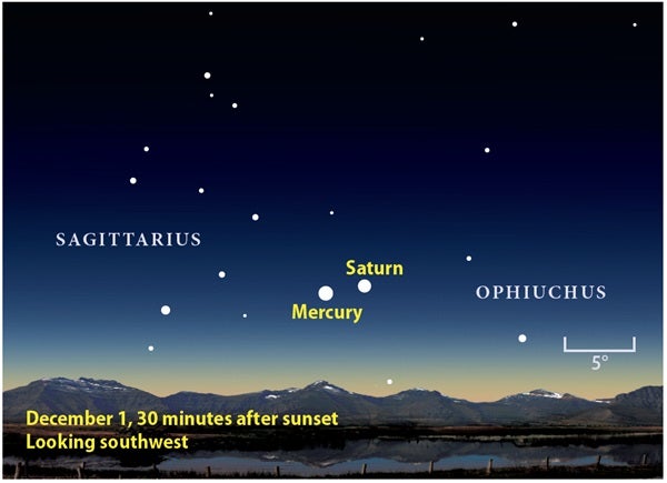

You’ll have to look quickly to see the evening’s first two planets. Mercury and Saturn lurk low in the southwest after sunset during December’s first week. On the 1st, they lie within 3° of each other and appear about 5° above the horizon a half-hour after sundown.
Mercury shines at magnitude 0.1 and is slightly easier to see than its magnitude 0.5 neighbor. Both planets dip lower with each passing day and disappear within a week. Mercury also dims quickly, dropping below Saturn’s magnitude by the 4th. The inner planet slides between the Sun and Earth on December 12 and will return to view before dawn at month’s end. Slow-moving Saturn passes on the far side of the Sun from our viewpoint December 21 and will reappear in the morning sky in January.

These two planets lie low in the southwest after sunset in early December, their final evening appearances of 2017.
Astronomy: Roen Kelly

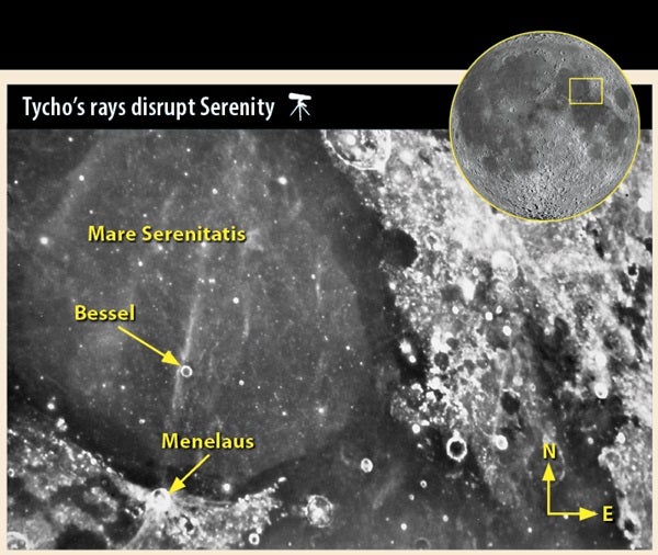

Consider doing some sidewalk astronomy at this month’s Full Moon. You can bet the media will hype this as the “Super Moon” because it is 2017’s closest and biggest Full Moon. Although the attention may be a bit misplaced, there’s no harm in taking advantage of it to show Luna to those who’ve never seen it through a telescope before.
Let the weather forecast determine whether to set up the evening of December 2 or 3. Full phase arrives at 10:47 a.m. EST on the 3rd, but being a half-day off from this time won’t affect the Full Moon’s most striking feature: the crater Tycho and its magnificent ray system. The long, white lines formed when the high-speed impact that gouged out the crater excavated bright lunar soil and sprayed it outward.
A dark ring surrounds the 53-mile-wide crater, but the impact scar itself doesn’t look impressive. The rays are another story. Follow the longest ray to the northeast, where eventually it splits Mare Serenitatis (Sea of Serenity) nearly in half.
At the southern edge of Serenity lies the crater Menelaus. The sharp edges and light-hued debris apron of this 17-mile-wide feature are signs of relative youth, just like with the smaller crater Bessel farther along the ray. It appears as if Bessel disrupted the spray from Tycho, creating a sheltered spot on its north side. But it’s tough to be sure because other interrupted rays have no nearby crater.
The lava filling the Serenity basin is more ancient. The darker shade covering the sea’s southern shore is about 3.8 billion years old, while the lighter layer to its north clocks in closer to 3 billion years.

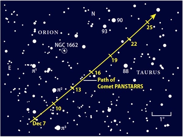

Most bright comets gain attention during brief, close passes by the Sun or Earth. But Comet PANSTARRS (C/2016 R2) never comes real close to our star or planet. Instead, this visitor from the Oort Cloud appears reasonably bright because its icy nucleus is ejecting gas and dust at a higher-than-normal rate.
The comet’s large orbit also means that it moves fairly slowly, and it will be a fixture in the evening sky into mid-2018. It pierces Orion’s Shield this month before skimming past the Hyades star cluster in January, the Pleiades in early February, and the bright star Capella in late April and early May.
Plan to observe under a dark sky if you want a detailed view of this dirty snowball in December. Astronomers expect the comet to glow around 10th magnitude, so you’ll need a 4-inch or larger telescope to spot its glow.
Earth crosses the comet’s orbital plane December 12 and 13, an event nicely timed for the dark of the Moon. This special perspective means we see the fan-shaped tail turned edge-on, so it flattens into a line, though the feature might be hidden behind the circular shape of the comet’s head, or coma. PANSTARRS lies within 1° of magnitude 4.4 Pi2 (π2) Orionis these two evenings.
And for a few nights in mid-December, C/2016 R2 glides within a couple of degrees of open star cluster NGC 1662 near the Orion-Taurus border. The cluster appears as a clump of roughly 10 stars, an understated brooch on Orion’s Shield. They shine between 8th and 10th magnitude, however, so they stand out from their surroundings. A 4-inch scope from the suburbs does NGC 1662 justice.

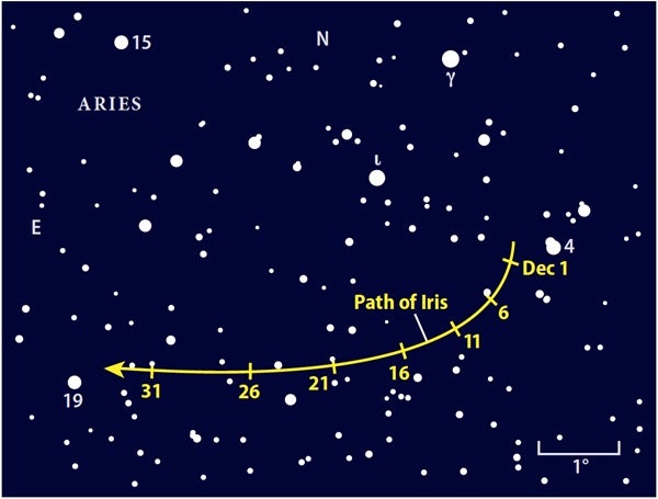

Asteroid 7 Iris arcs gracefully through Aries the Ram during December. This region climbs three-quarters of the way from the southern horizon to the zenith by 8 p.m. local time and doesn’t set until well past midnight. You can hunt for Iris on any clear evening, though it’s best to avoid the month’s first and final days when a nearly Full Moon stands nearby.
Iris fades from magnitude 7.7 to 8.5 in December, which places it within reach of small telescopes from the suburbs and binoculars under a dark sky. Use 5th-magnitude Iota (ι) Arietis and 6th-magnitude 4 Ari as your guides early in the month. On December 5 and 6, drop 1° southeast of 4 Ari to a pair of slightly unequal stars. Iris is the western “star” on the 5th and the southern one on the 6th. A few nights later, Iris appears alone in a field of significantly fainter stars.
Tracking an asteroid for a few months gives you a sense of their retrograde loops — the east-to-west motion outer solar system objects experience as Earth overtakes them in its faster orbit. The retrograde loops of main belt asteroids, like Iris, are smaller than Mars’ and wider than Jupiter’s.
