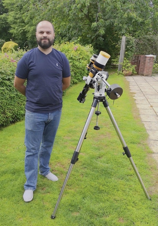

ASYCC0321_09
The author stands next to one of his portable astroimaging setups.
