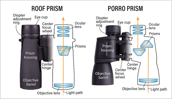

Because the prisms in roof prism binoculars are in line, they are easier to hold. But the offset prisms of Porro prism binoculars often provide a wider field of view and greater depth of field than comparable roof prism models.

If you’re in the market for binoculars, here are the basics. Each barrel is a low-power, wide-field refracting telescope with internal prisms that serve to undo the upside-down image produced by astronomical refractors. Binoculars come in two main designs: roof prism and Porro prism. The latter option is preferred for astronomy, partly because it allows more light to reach the eyes. Fully coated optics and prisms made of BaK4 (barium crown) glass also enhance the view.
Of the many sizes available, 7×50 binoculars are generally the go-to for astronomical observing. Binoculars with only a center focus don’t take into consideration the different visual capabilities of each eye. However, binos that combine center focus (both barrels simultaneously) with the ability to make so-called diopter adjustments (each barrel individually) allow you to tailor the focus finely to each eye.
