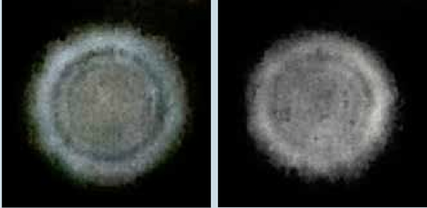

Shown here are the cellphone images I captured while performing the star test with the artificial light. You can see that the inside (left) and outside (right) of focus images look almost exactly the same and are both nice and crisp. These images were taken using a Celestron NexYZ adapter to hold my phone.

With any new scope, I always begin with star testing to ensure the optics are in good shape. I use Harold Richard Suiter’s wonderful book Star Testing Astronomical Telescopes (Willmann-Bell, 2009), which explains how to test each type of telescope, as my reference.
Testing the SVX 152T on a real star proved the optics are excellent, but thanks to Earth’s turbulent atmosphere, I had only fleeting moments to see the diffraction rings come in and out of focus. Following Suiter’s guide, I used an artificial star to reduce those effects. Suiter says that for a 6-inch f/8 optical system, using a point source with a 0.1-millimeter aperture placed at a distance greater than 80 feet (24 m) should be sufficient, although it may cause a bit of undercorrection.
To perform my test, I used a small artificial star device that has several different size apertures, including a tenth of a millimeter. I equipped the scope with a 5mm Takahashi eyepiece at 241x magnification. After placing the scope on a table, I moved the light source 100 feet (30 m) away and ran the test. I saw only a slight difference between the rings, with the outside focus just a bit more defined. This was due to the slight undercorrection expected from the short distance to my artificial star.
I did my best to document the star test, but getting images proved harder than I expected, as a bit of turbulence still existed across the grassy surface of my backyard. The resulting cellphone images (shown above) are much less defined than what I visually saw through the eyepiece.
