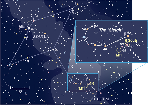

Your first step is to find R Scuti. Before going outside, get a feel for its general location by referring to our Star Dome map on page 34. R Scuti’s parent constellation, Scutum, is rather faint and obscure, but you can find it southwest of the prominent constellation Aquila. A line traced from Gamma (γ) Aquilae to Delta (δ) Aquilae and extended roughly an equal distance beyond brings you to Lambda (λ) Aquilae, which is a few degrees east and slightly north of the open cluster M11. R Scuti is conveniently located near this cluster. In fact, on the Star Dome map, R Scuti is the unlabeled star that appears near the upper-right portion of the dashed circle marking M11.
Once outside under the real night sky, trek from Gamma to Lambda Aquilae with your binoculars. Lambda is the brightest star in a sleigh-shaped asterism that ends with the star Beta (β) Scuti. M11, which appears as a fuzzy patch in binoculars, lies about 2° south-southeast (below and slightly left) of Beta. Immediately northwest (above right) of M11 is a small trapezium of stars that includes R Scuti. This entire group is shown in the close-up chart on this page.
After you’ve found R Scuti, it’s time to estimate its brightness. The chart shows the magnitudes of other nearby stars, with decimal points omitted to avoid being mistaken for stars themselves. Make your brightness estimate of R Scuti by seeking a neighboring star of the same magnitude. If that’s not possible, and it usually isn’t, look for “bracketing” stars — one that’s slightly brighter and one that’s slightly fainter than your target — then interpolate the magnitude. Because R Scuti’s variations occur over months, there’s no need to observe it every night; clouds won’t allow that luxury anyway. I generally check out R Scuti once every five to seven nights.
