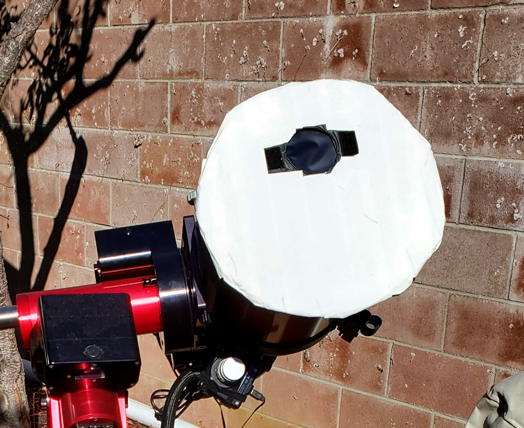

If you plan on using binoculars or a telescope for the eclipse, a solar filter that securely covers the objective is essential for safe viewing. Various kinds of glass and film filters in different sizes are available from astronomy-gear vendors, and they should be rated ND 5.0, meaning they block 99.999 percent of the Sun’s light. The filter itself and surrounding opaque material must block the telescope’s entire objective lens. Be sure to cover finder scopes and guide scopes as well, with lens caps, cardboard, or other opaque materials. Filters at the eyepiece alone are not safe, as heat can build up inside the telescope and break the telescope or the filter. And make sure that solar filters are securely attached with nylon screws, tape, Velcro, or other means to keep the wind or a passerby from accidentally knocking it off, blinding the observer.

An exciting and public event-friendly way of viewing the partial eclipse phases and sunspots is with solar projection through a telescope. Instead of using a solar filter, sunlight is allowed through the telescope and is projected out of the eyepiece onto the ground or a white sheet or board. To focus the image, move the screen closer to or farther from the telescope. A low-power eyepiece, about 15–20mm, and a short-focal-length refractor are ideal. In order to prevent heat buildup, you need to make an aperture mask that blocks the telescope’s objective except for a round hole about 1¾ inches (45 mm) or smaller across. It is important to not look through the telescope’s eyepiece! Set up the telescope and board in such a way that prevents anyone from looking into the eyepiece and be sure someone is constantly present to supervise.
