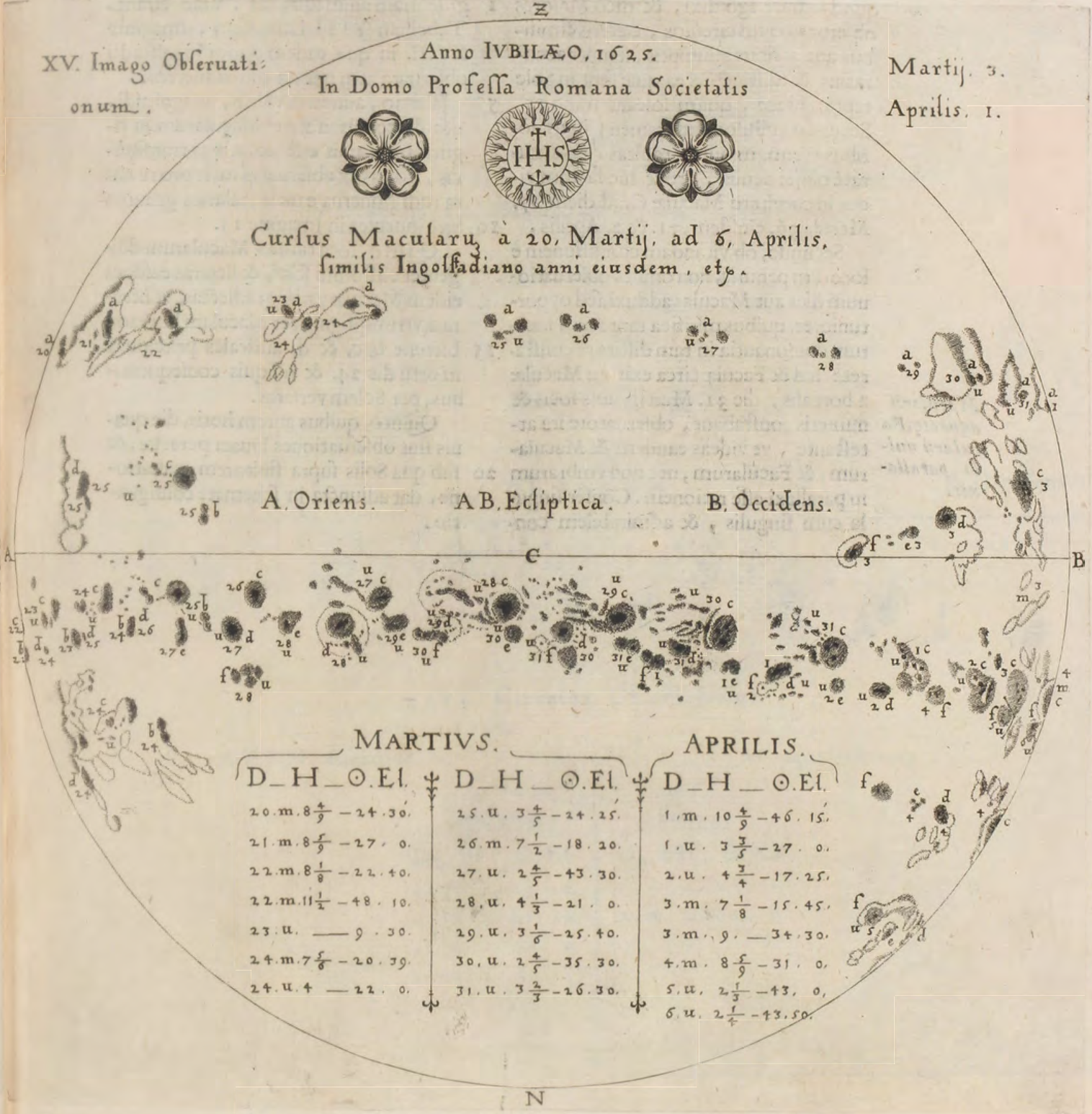

Among the first solar astronomers was Galileo Galilei, who in 1610 used a crude refractor to project solar images onto paper and produce sketches of sunspots as they moved across the Sun’s disk. The following year, Christoph Scheiner, a Jesuit mathematician, also began sketching sunspots with remarkable accuracy.
Scheiner wished to preserve his religious belief in the “perfection” of the Sun and argued that sunspots’ movements indicated that they were orbiting the Sun like satellites. Galileo countered that the “blemishes” appeared to be on the surface of the Sun, and that the Sun itself rotated. After years of debate and much further study, Scheiner was forced to abandon his belief in the Sun’s perfection and admit that sunspots were changing surface features.

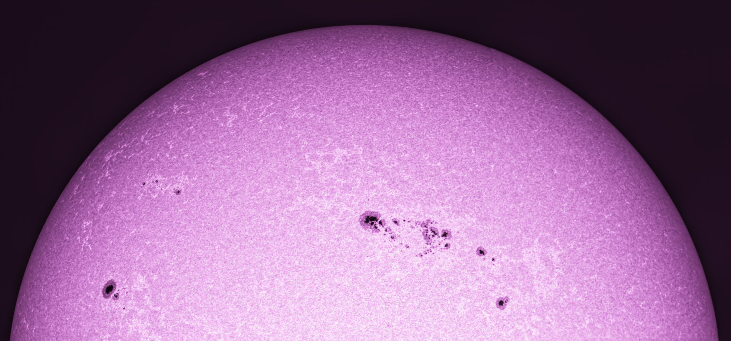

Narrowband solar imaging isolates specific wavelengths to highlight distinct layers of the Sun’s atmosphere. One early target was the Calcium-K (CaK) line at 393.4 nanometers, which reveals magnetic activity in the chromosphere, the layer above the photosphere. CaK filters, often used in specialized solar telescopes, show bright plage regions around sunspots and intricate chromospheric networks. These images offer insights into magnetic activity but often require ultraviolet-sensitive cameras due to the wavelength’s proximity to the violet end of the visible spectrum.

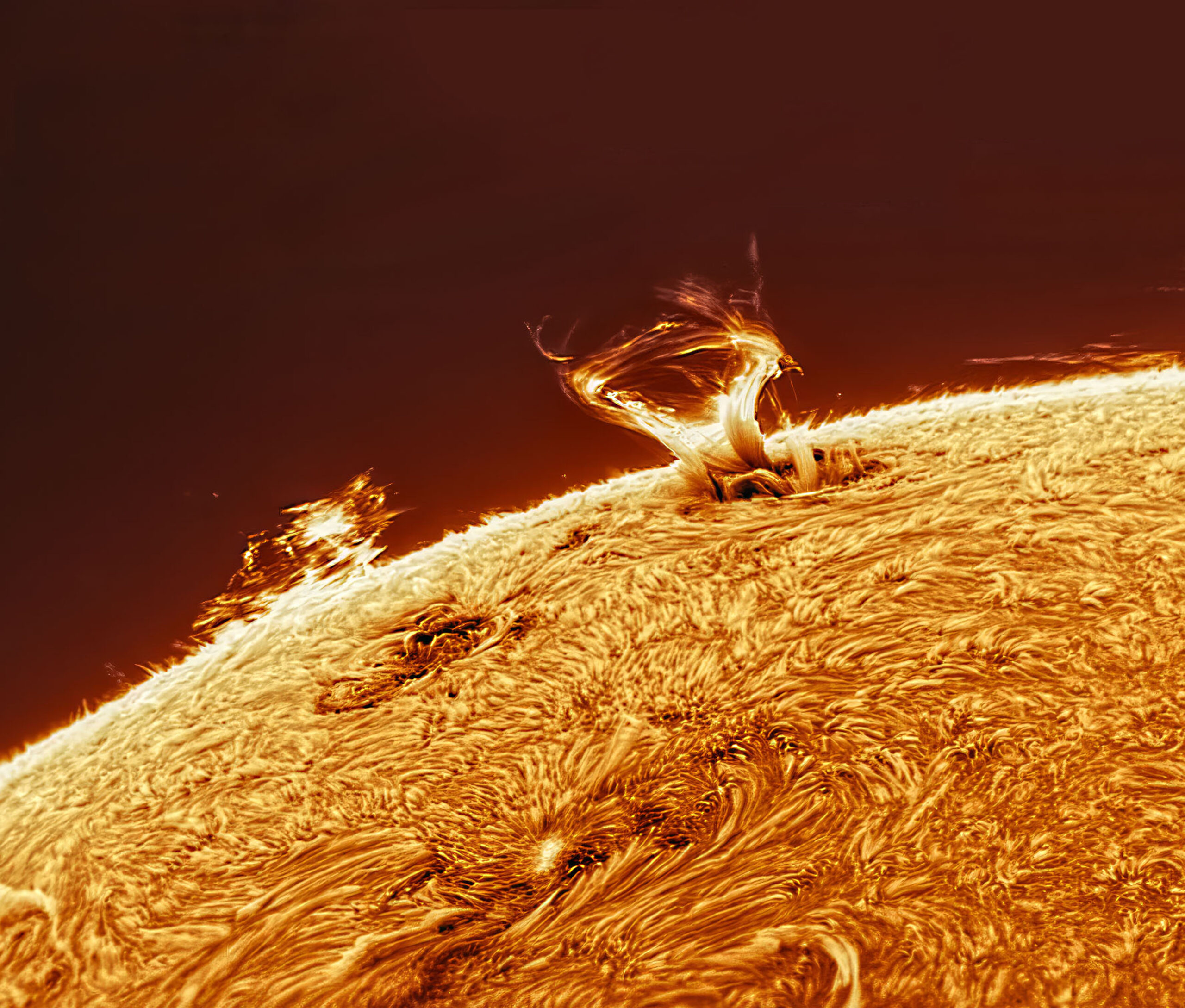

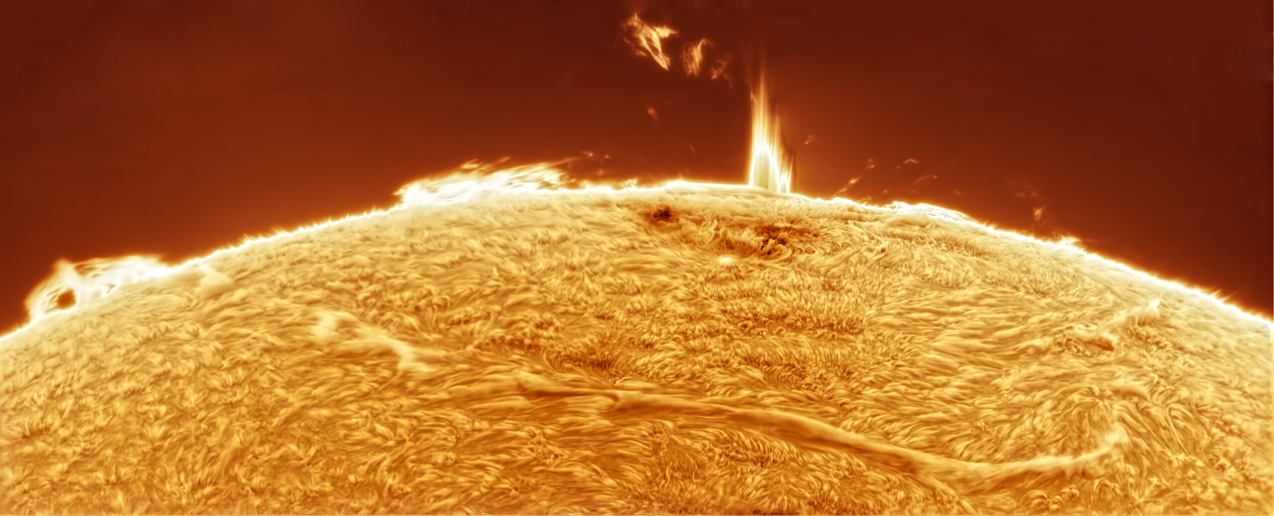

While CaK imaging remains valuable, it has been overshadowed by the gold standard of solar observation: Hydrogen-alpha (Hα) imaging. Hα, centered at 656.28 nanometers, unlocks a vivid view of the chromosphere’s dynamic features, from fiery prominences to dark filaments and explosive flares.

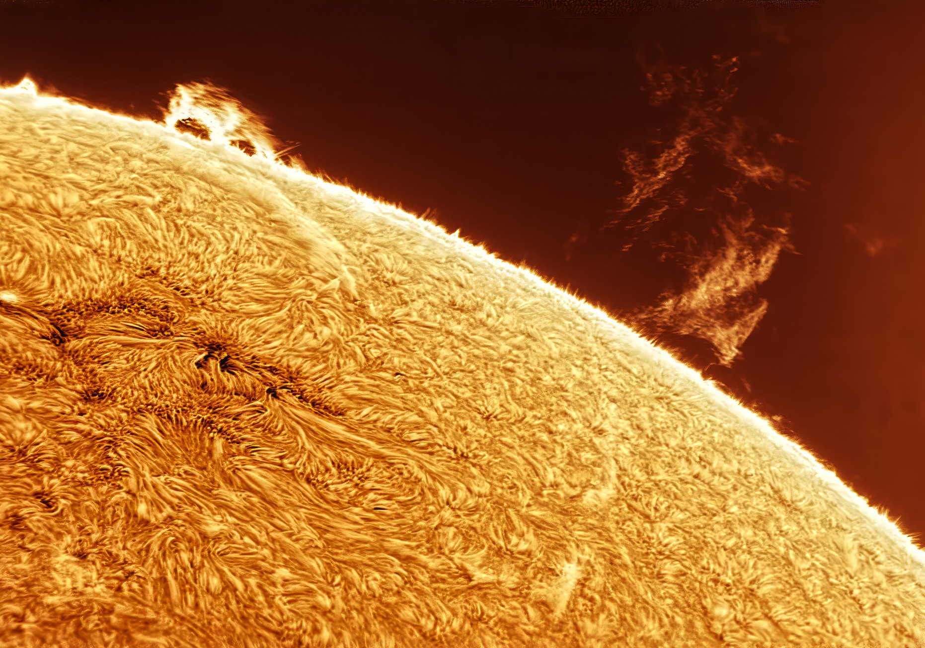

Finally, software like Topaz Photo AI can remove noise, resulting in breathtaking color photos. Amateurs now routinely capture prominences curling into space, filaments snaking across the disk, and flares erupting in real time. Some advanced amateurs are even producing images and time-lapse animations that rival professional observatories. Online communities share these images, supporting a global network of solar observers and enthusiasts.

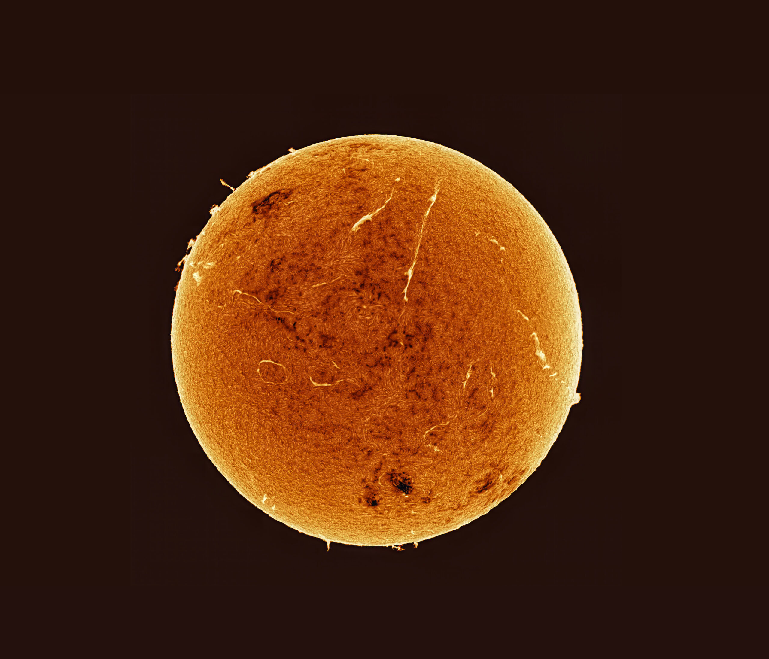

Hα imaging dominates modern solar observation. The Hα line corresponds to the first Balmer transition of hydrogen, abundant in the chromosphere. By isolating this narrow wavelength — typically with devices called etalons — astronomers can study the motion of the Sun’s plasma, its magnetic fields, and transient events like solar flares.

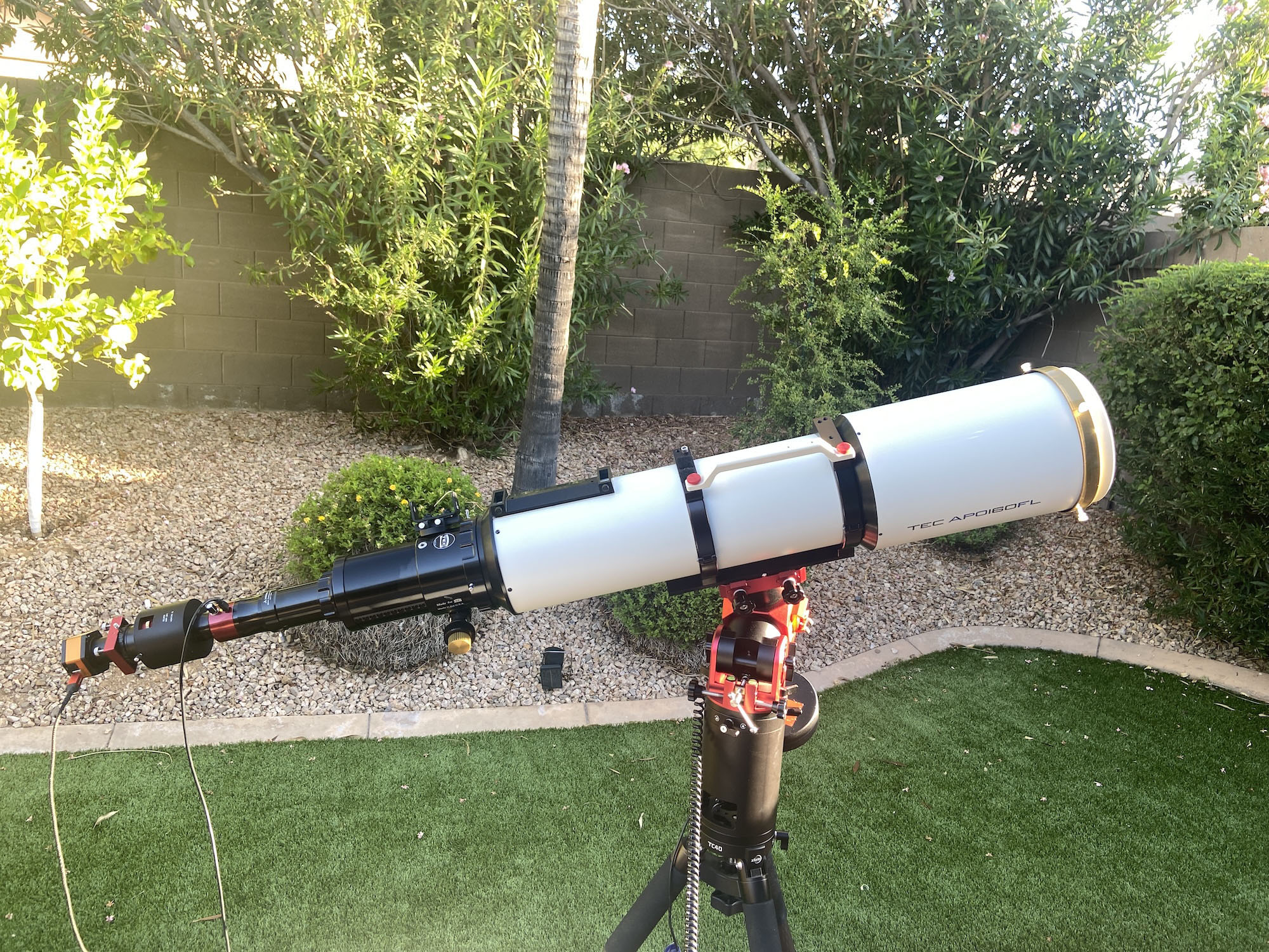

The first and simplest are tilt-tuned etalons. These filters use a Fabry-Pérot etalon — a pair of partially reflective plates that transmit only a narrow wavelength band. Tilting the etalon shifts the transmitted wavelength, allowing observers to tune the filter to the Hα line. The etalon can also be tuned slightly off-band to emphasize features whose wavelengths are Doppler-shifted, like fast-moving prominences. Tilt-tuned systems, common in entry-level Hα telescopes, are effective but can be expensive if they have to cover larger apertures.
Pressure-tuned etalons are more advanced and used in telescopes like those produced by Lunt Solar Systems. These devices adjust the etalon’s refractive index by varying the air pressure between the plates. This method provides uniform tuning across the field, improving image consistency. Pressure-tuned etalons are often combined in series (double-stacked) and excel in high-resolution imaging. They are capable of capturing prominences and intricate details like spicules — jetlike structures in the chromosphere, the layer of the Sun’s atmosphere above its visible surface.
The third approach is solid etalons, which use a single solid medium — typically crystals of the silicate mica — to isolate Hα light. Solid etalons, such as those made by Daystar or Solar Spectrum, require power and a warm-up period to bring them on-band, but are less sensitive to temperature or pressure changes, making them ideal for long imaging sessions. While pressure or tilt systems are usually integrated into a solar telescope design, solid etalons are often sold as a standalone option for refracting telescopes.

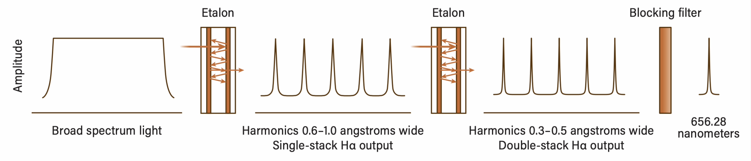

An etalon consists of two parallel, partially reflective surfaces spaced a tiny distance apart. When light enters this cavity, it bounces back and forth between the surfaces, creating reflected beams. These beams overlap and combine, producing an interference pattern — a set of bright and dark spots or “fringes” caused by light waves reinforcing or canceling each other.
This interference occurs because only wavelengths that fit an exact number of half-wavelengths in the spacing between the plates line up perfectly (constructive interference) and pass through strongly. Wavelengths that don’t fit this pattern interfere destructively and are blocked.
The result is a series of narrow transmission peaks — the desired wavelength (such as the Hα line) plus other wavelengths that are harmonics of that wavelength. Stacking two etalons narrows these peaks further. Finally, a blocking filter selects just one of these harmonics while blocking others.
