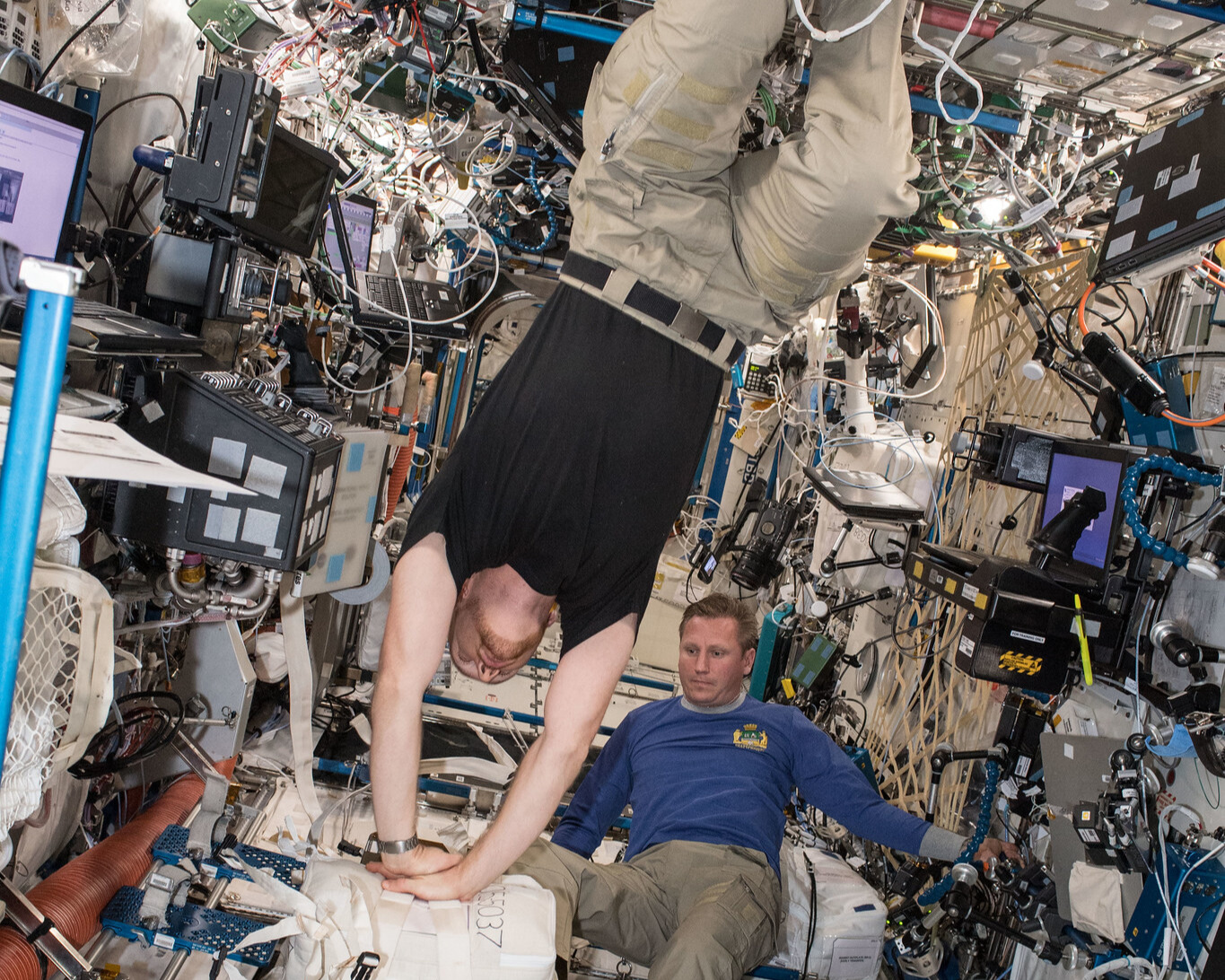

The first problem — the one addressed by the French experiment in the jet — occurs in the weightlessness of spaceflight, where the basic physics of the procedure breaks down. Without weight, pushing on a patient’s chest simply sends both rescuer and patient floating apart. CPR requires both a compression force on the patient’s heart and a counter-force to hold the patient in place. On Earth, that counter-force is gravity. In a study presented at the 2025 European Society of Cardiology Congress, Reynette and his team investigated the effectiveness of the currently approved manual technique designed to overcome this problem.
For decades, the approved, albeit physically demanding, solution has been the “handstand” technique. This maneuver requires the rescuer to perform a modified handstand, placing their hands on the patient’s chest while bracing their feet against a wall or ceiling of the spacecraft to generate the necessary downward force for compressions.
Despite being the standard for years, the French study proved this acrobatic method falls short. The technique achieved a median compression depth of just 1.36 inches (34.5 millimeters), well below the 1.97- to 2.36-inch (50 to 60 millimeters) range required to keep blood flowing to the brain.
