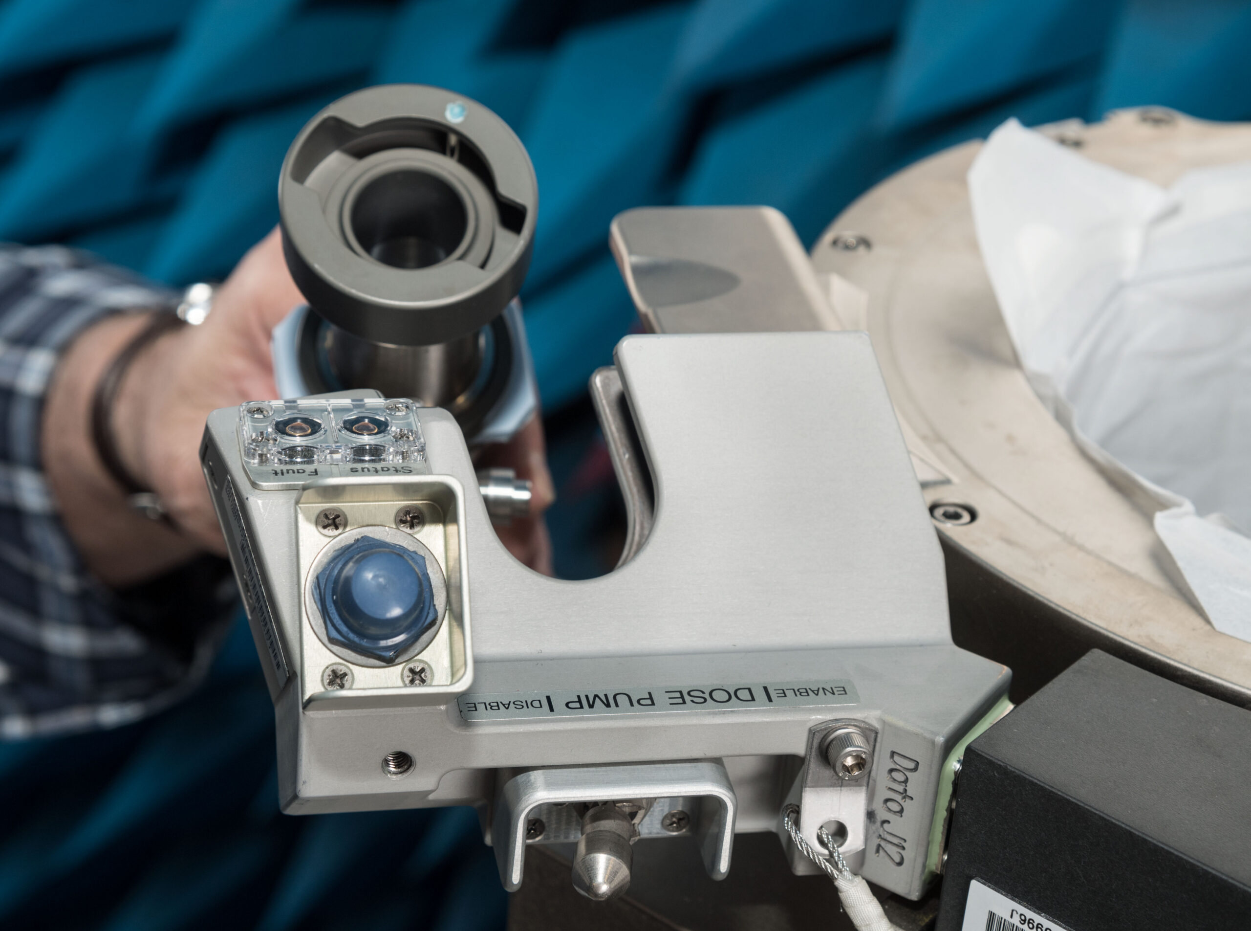

Soon after launch, NASA confirmed that there was a problem with the toilet fan on the Orion spacecraft. The issue was due to a malfunctioning controller — a part in the toilet’s control system — said NASA associate administrator Amit Kshatriya at a press conference. The particular difficulty for Artemis 2’s toilet meant that while astronauts could still poop in the toilet, they couldn’t pee in it.
In space toilets, fans aren’t there just to air the place out. In zero gravity, the airflow also helps pull waste into the toilet, preventing it from drifting into the cabin. This was a real problem on Apollo and earlier missions, where the spacecraft had no toilets and astronauts had to poop in plastic bags taped to their butts. A faulty seal could lead to incidents of the kind experienced most infamously on Apollo 10. (An example line from the mission transcript: “Give me a napkin quick. There’s a turd floating through the air.”)
RELATED: How astronauts go to the bathroom in space
Late Wednesday night (EDT), mission specialist Christina Koch took on the role of space plumber, removing parts from the toilet and executing a series of steps radioed up from Houston while controllers on the ground monitored the toilet’s systems and took remote troubleshooting measures, including turning it on and off.
The fix worked.
“Happy to report that toilet is go for use,” said CapCom Amy Dill after the last of Mission Control’s remote evaluations. “We do recommend letting the system get up to operating speed before donating fluid and then let it run a little bit after donation,” she added, in an impressive piece of NASA jargon.
“We are cheers all around,” Koch responded.
