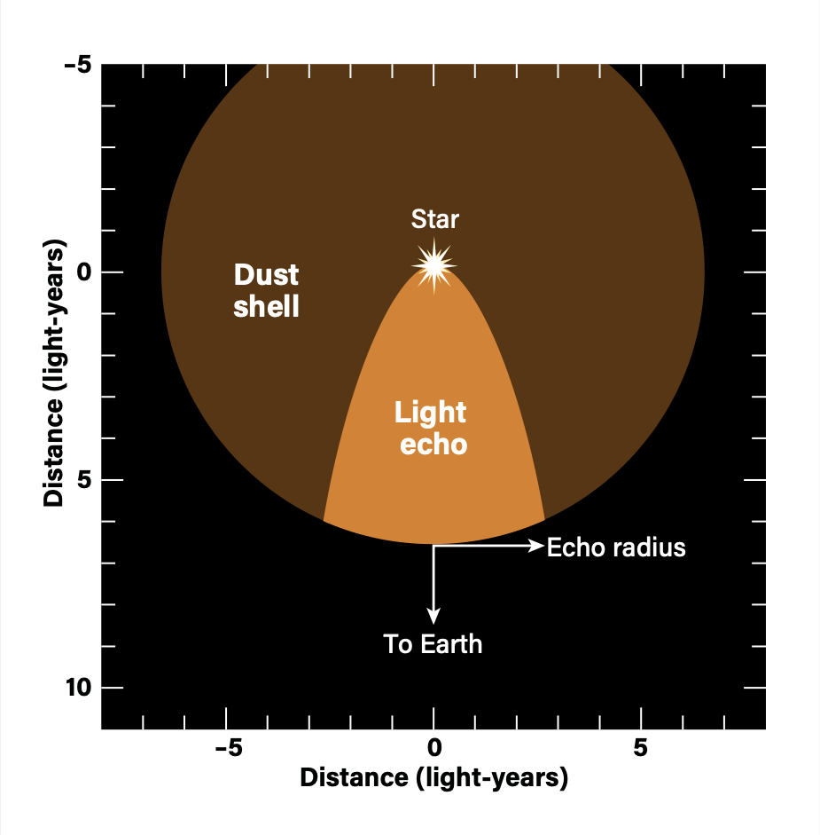

Consider the Hubble image of the light echo of the erupting star V838 Monocerotis, taken in October 2002 — about 230 days after the light of the explosion peaked in March that year. Yet, the light echo at that time appears to have a radius of about 3 light-years. How could the light from the explosion travel 3 light-years in less than one year?
The answer lies in the geometry of a light echo, illustrated in the diagram above. Here we see V838 Mon at the center, surrounded by a shell of interstellar dust extending out to a radius of about 6 or 7 light-years. At any moment in time, the light echo lies on a paraboloidal surface. This surface marks the location in space where the extra travel time for light to bounce off dust and reach Earth is 230 days. The illuminated dust that appears to be 3 light-years to the side of V838 Mon is actually almost 6 light-years in front of the star. So, it’s almost as if we are staring into a long tunnel in the dust, with the star nearly at the back end of the tunnel. The speed of light has not been violated!
As time passes, the paraboloid opens up and propagates into the background. Thus, each Hubble observation sampled a different region in the surrounding dust as the illumination swept through it. It’s an astrophysical CAT scan!
