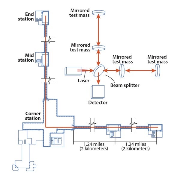

This diagram shows the layout of the observatory in Hanford, Washington. By making laser light travel up and down the arms and interfere with itself, scientists can deduce minute changes in the light’s path from a gravitational wave encounter.
Astronomy: Roen Kelly
At each observatory, the two-and-a-half-mile (4-km) long L-shaped interferometer uses laser light split into two beams that travel back and forth down the arms (four-foot diameter tubes kept under a near-perfect vacuum). The beams are used to monitor the distance between mirrors precisely positioned at the ends of the arms. According to Einstein’s theory, the distance between the mirrors will change by an infinitesimal amount when a gravitational wave passes by the detector. A change in the lengths of the arms smaller than one-ten-thousandth the diameter of a proton (10-19 meter) can be detected.
