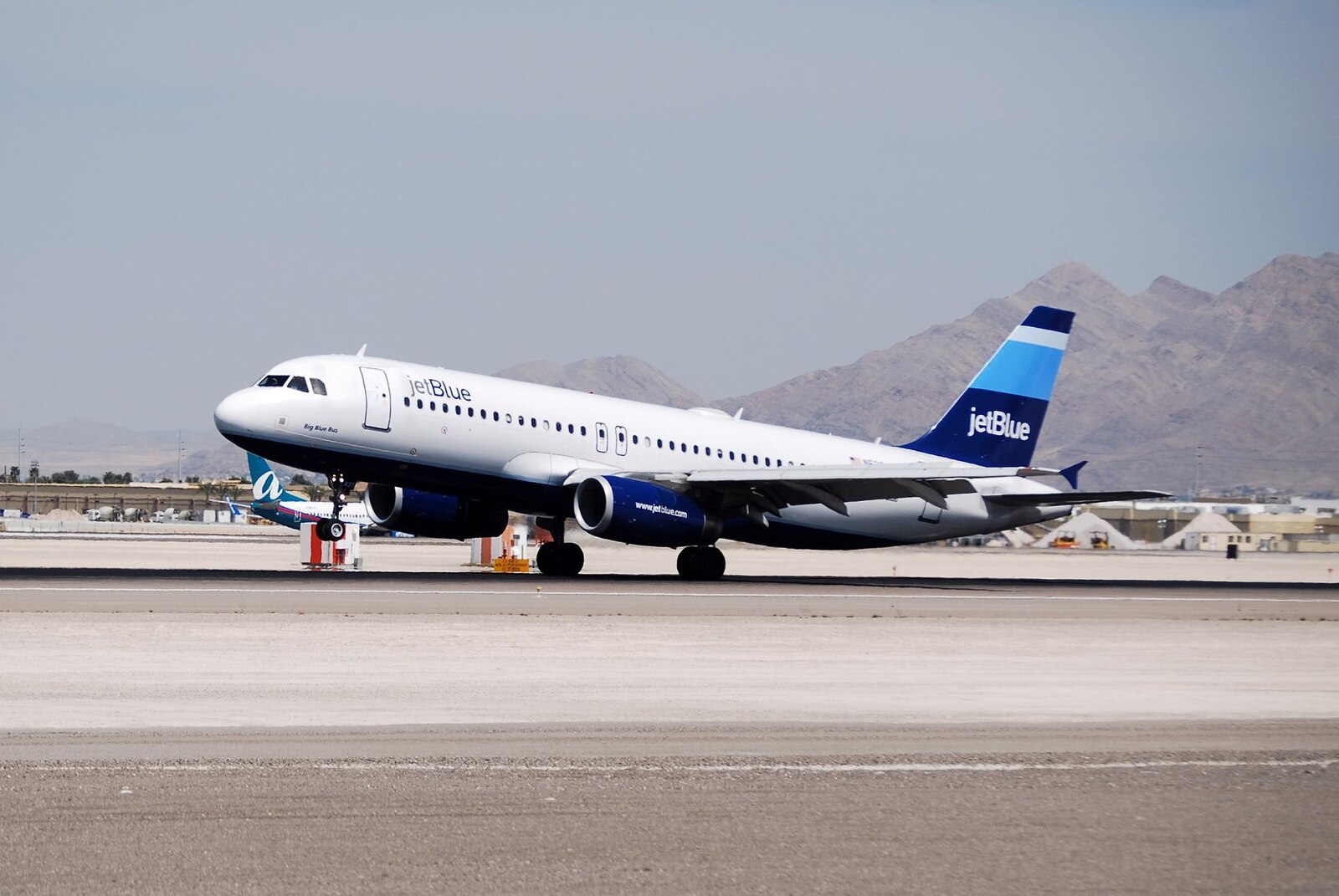

Last month, European regulators grounded thousands of Airbus jetliners, citing an unusual reason: solar radiation. The planes’ electronics, the manufacturer said, were vulnerable to the charged particles streaming from the Sun and into Earth’s atmosphere, which could cause a plane to lose control and, in a worst case scenario, subsequently break apart in midair.
The Nov. 28 order, known as an Emergency Airworthiness Directive, was issued by the European Union Aviation Safety Agency and required operators of specific Airbus A319, A320, and A321 aircraft to replace their onboard Elevator Aileron Computers (ELAC) — units responsible for controlling the aircraft’s pitch and roll.
The regulatory action followed an event on Oct. 30, 2025, involving a JetBlue flight traveling from Cancun, Mexico, to New Jersey. The aircraft suddenly lost altitude in what the directive called an “uncommanded and limited pitch down”. The directive notes that while the crew regained control, the loss of altitude did result in passenger injuries. According to reporting from CNN, 15 passengers were hospitalized.
A preliminary technical assessment by Airbus identified a malfunction in the ELAC unit as a probable contributing factor. In a press release, Airbus stated that “intense solar radiation may corrupt data critical to the functioning of flight controls.”
As a precautionary measure, Airbus advised operators to replace affected units with an older, serviceable version. For most of the fleet, this meant rolling back a recent software update. In a Dec. 1 update, the manufacturer confirmed that approximately 6,000 aircraft were potentially impacted by the issue. Airbus also reported that the “vast majority” had already received the necessary modifications, with fewer than 100 aircraft remaining to be fixed before returning to service.
Researchers say it’s still unclear whether the Sun was the culprit behind the JetBlue incident. But, they say, the incident highlights the very real potential for space radiation to corrupt computer data as it zips through microchips — something that satellites and airliners are designed to mitigate. It also highlights the potential impact that space weather can have on the infrastructure underpinning our modern world.
