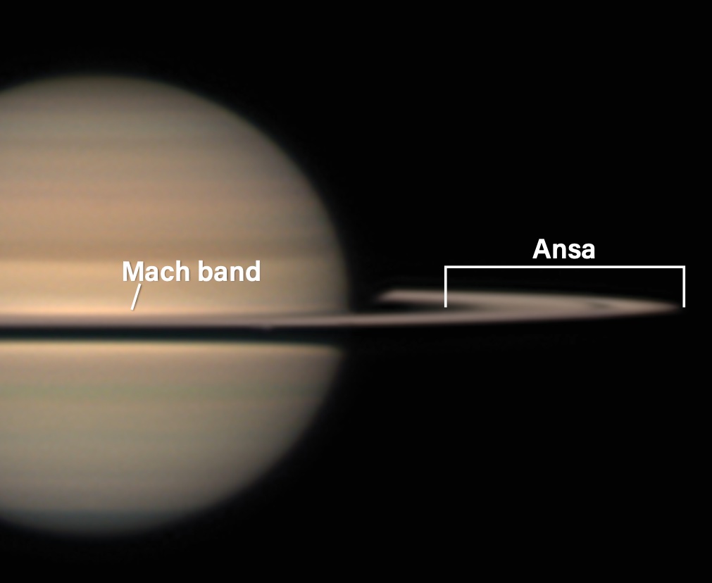

On the morning of June 9, I was showing my wife, Deborah Carter, Saturn in bright twilight through my 3-inch Tele Vue refractor. As I described the planet and the near-edge-on appearance of the rings (2.0°), she picked out several features, including the narrow rings on either side of the planet, the shadow of the planet on the rings, and vice versa. However, neither of us could see the rings passing in front of the globe.
After a prolonged study of the ring’s shadow with direct vision, I averted my gaze toward one of the rings’ ansae — the bright “handles” that appear on either side of Saturn where the rings arc around the planet. Suddenly and fleetingly, I saw what appeared to be the full extent of the rings cutting across the face of the planet. They appeared bright against the planet’s equatorial belt and hugged the northern edge of the ring’s shadow — although I was suspicious.
At and near the center of the planet, the rings appear highly foreshortened, appearing much thinner than they do at the ansae. Furthermore, ring-particle shadowing effects make that projected section of the ring appear darker at center than they do at the ansae. What I saw had to be an illusion.

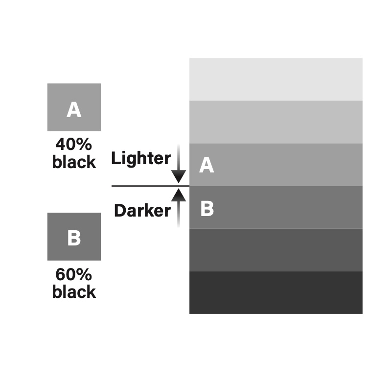

The Mach effect occurs when a light and dark object are adjacent, causing brighter and darker bands to appear at the edges.
The Mach effect occurs when a light and dark object are adjacent, causing brighter and darker bands to appear at the edges. Credit: Astronomy: Roen Kelly

With these words in mind, I observed Saturn again on the mornings of June 18 and 19, following the planet well into twilight. While my observation and Barnard’s were different, both dealt with the ring’s shadow. After staring at the ring’s shadow for a prolonged period of time and then averting my gaze to the side of the planet, I could create a similar, albeit fleeting, optical illusion that exaggerates the edge of the bright equatorial zone next to the ring’s shadow. This phenomenon is known as a Mach band, or the Mach effect. It’s an optical illusion where the edge of a bright object next to a dark object appears even lighter, and vice versa.
One can also see Saturn’s rings projected a short way across the face of the planet, where they taper like pincers. I found that the best time to see this ring aspect is during bright twilight when contrast between the planet and the sky is at its lowest. I call it “ghosting” because the appearance through a small telescope looks like a ghostly apparition.
