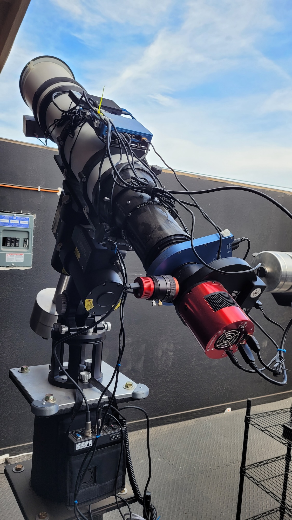

First, consider your equipment — both the physical hardware and the software to run it. It’s important to remember that you won’t have the option to go outside and adjust something if an issue pops up, so you need equipment that is robust, reliable, and state of the art. A typical imaging kit will consist of the following hardware:
Almost any high-quality telescope will work as your photon collector. The centerpiece of your imaging kit will be the mount, plus a sturdy tripod or pier to connect it to. You want a mount designed for robotic use, such as an Astro-Physics Mach2GTO or 10Micron series mount. These mounts come with absolute encoders, so if the power is lost, the mount will know where it is when power is restored. Alternatively, other mounts have home positions — a location the mount can be commanded to go to if there’s a loss of power.
Next is the imaging train itself. This can consist of several items: camera, filter wheel, field rotator, electronic focuser, and either an off-axis guider or an external guide scope. It’s also important to have a dew heater as well as either an electronic flat panel or lens cover to protect the optics when the scope is not in use. Most remote sites sit on high desert plateaus where it can get quite windy at times, which can kick up a lot of dust, so you’ll want your optics protected.
There are also power distribution requirements. Most remote facilities require an uninterruptible power supply and recommend a web power switch so that you can recycle power to your equipment remotely if it’s inadvertently shut off. Several companies manufacture power distribution and USB hub solutions, such as PrimaLuceLab and Pegasus Astro, which allow you to connect all your USB devices and 12-volt DC power cords to a common box on top of the scope. Such a setup aids greatly in cable management as well.
Finally, you’ll need a computer to run all this equipment. I use a MeLE Quieter 4C — it’s compact, has no moving parts, and can easily sit on top of a scope. Having the computer sit atop the imaging kit means one cable fewer hanging off the system. Various brands of minicomputers are available and they usually cost around $200.

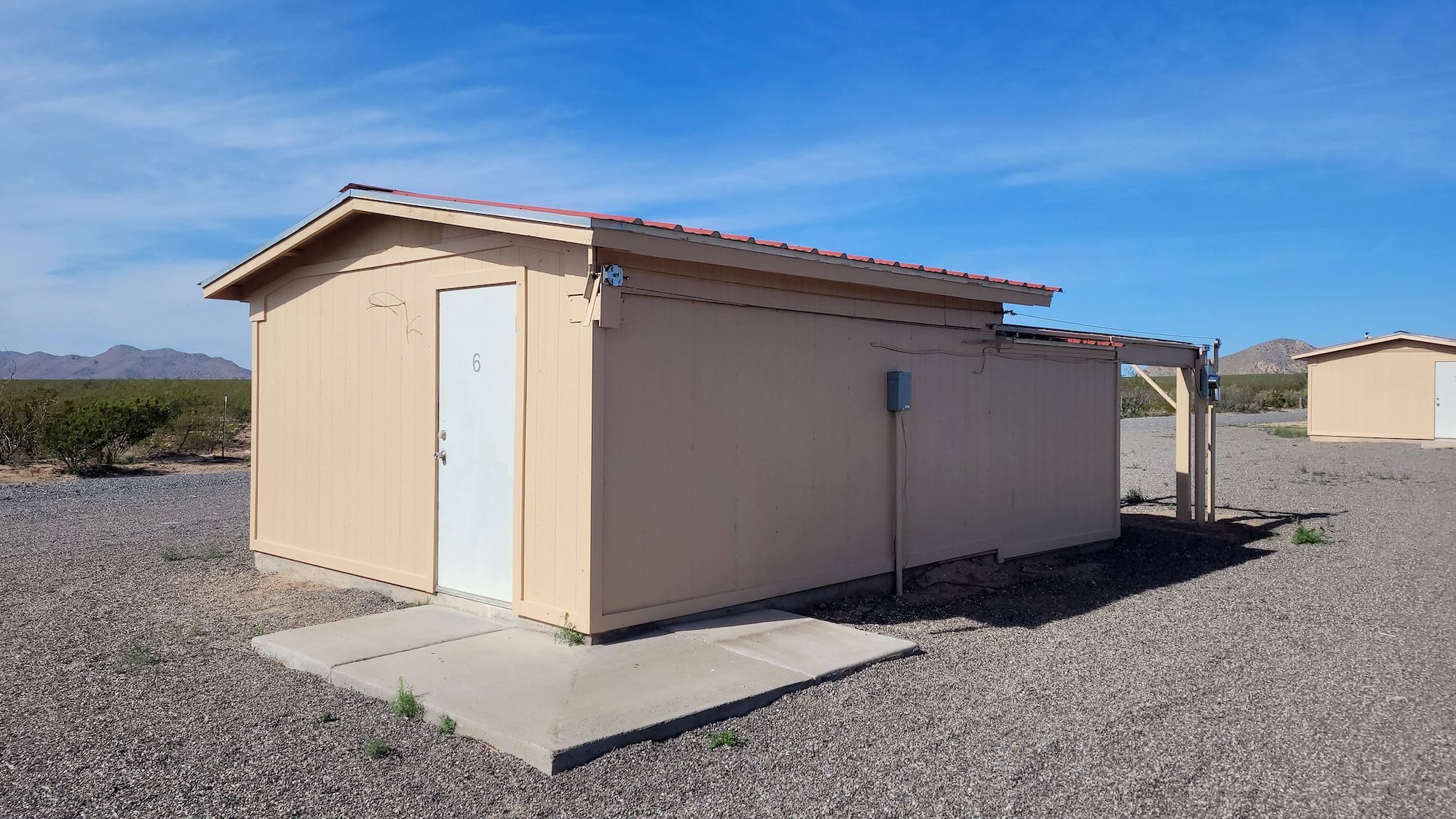

Costs for hosting sites vary depending on location and observatory size. I have my kit set up at Deep Space Products Remote, located in Animas, New Mexico, in a roll-off roof observatory that’s shared with three other kits. I pay $600 a month to rent this pier, which is a fairly typical rate. Also check payment options — some facilities rent month to month with a first and last month’s rent agreement, others lease for a year at a time and give discounts for longer leases.
